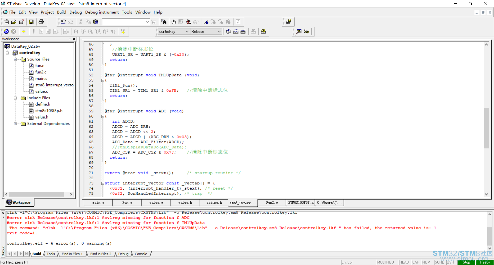

STVD中断问题 编译错误@svlreg missing for function
小彬有礼i 提问时间:2018-6-28 10:36 /
如图错误为#error clnk Release\controlkey.lkf:1 @svlreg missing for function f_ADC#error clnk Release\controlkey.lkf:1 @svlreg missing for function f_TM1UpData
The command: "clnk -l"C:\Program Files (x86)\COSMIC\FSE_Compilers\CXSTM8\Lib"  -o Release\controlkey.sm8 Release\controlkey.lkf " has failed, the returned value is: 1
exit code=1.
@far @interrupt void TM1UpData (void)
        TIM1_Fun();
        TIM1_SR1 = TIM1_SR1 & 0xFE;   //清除中断标志位
        return;
@far @interrupt void ADC (void)
         int ADCD;
         ADCD = ADC_DRH;
         ADCD = ADCD << 2;
         ADCD = ADCD | (ADC_DRH & 0x03);
         ADC_Data = ADC_Filter(ADCD);
         //FunDisplayDataDo(ADC_Data);
   ADC_CSR = ADC_CSR & 0X7F;    //清除中断标志位
        return;
把TIM1_Fun();和ADC_Data = ADC_Filter(ADCD);注释掉就可以通过编译,有没有大神帮帮忙,现在很绝望。。。。

@far @interrupt @svlreg void TM1UpData (void)
        TIM1_Fun();
        return;
@far @interrupt @svlreg void ADC (void)
         int ADCD;
         ADCD = ADC_DRH;
         ADCD = ADCD << 2;
        return;
试试加上@svlreg关键字

小彬有礼i 回答时间:2019-6-20 09:51:16
        TIM1_Fun();
可以了,谢谢
