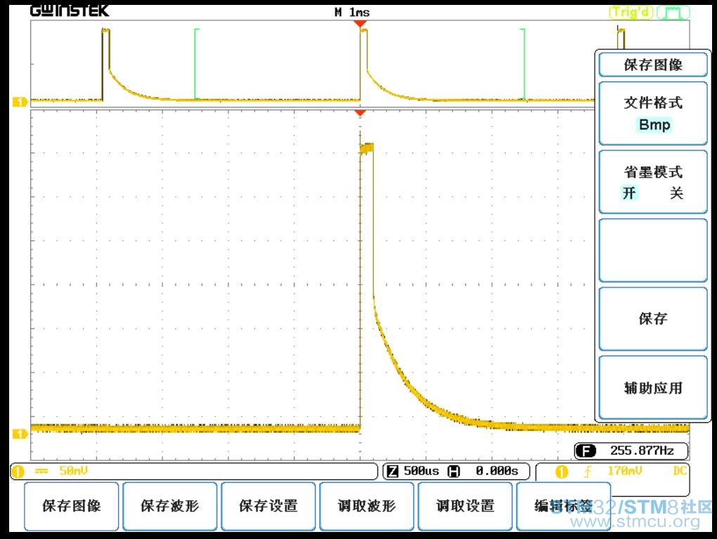

初始代码:
GPIO_InitTypeDef GPIO_InitStruct;
  /* GPIO Ports Clock Enable */
  __HAL_RCC_GPIOF_CLK_ENABLE();
  __HAL_RCC_GPIOA_CLK_ENABLE();
  __HAL_RCC_GPIOB_CLK_ENABLE();
  /*Configure GPIO pin Output Level */
  HAL_GPIO_WritePin(GPIOA, GPIO_PIN_6|GPIO_PIN_7, GPIO_PIN_SET);
  HAL_GPIO_WritePin(GPIOB, GPIO_PIN_1, GPIO_PIN_SET);
  /*Configure GPIO pins : PA0 PA4 PA9 PA10 */
  GPIO_InitStruct.Pin = GPIO_PIN_0|GPIO_PIN_4|GPIO_PIN_9|GPIO_PIN_10;
  GPIO_InitStruct.Mode = GPIO_MODE_INPUT;
  GPIO_InitStruct.Pull = GPIO_NOPULL;
  HAL_GPIO_Init(GPIOA, &GPIO_InitStruct);
  /*Configure GPIO pins : PA1 PA5 */
  GPIO_InitStruct.Pin = GPIO_PIN_1|GPIO_PIN_5;
  GPIO_InitStruct.Mode = GPIO_MODE_IT_FALLING;
  /*Configure GPIO pin : PA6 */
  GPIO_InitStruct.Pin = GPIO_PIN_6;
  GPIO_InitStruct.Mode = GPIO_MODE_OUTPUT_PP;
  GPIO_InitStruct.Speed = GPIO_SPEED_FREQ_HIGH;
  /*Configure GPIO pin : PA7 */
  GPIO_InitStruct.Pin = GPIO_PIN_7;
  GPIO_InitStruct.Pull = GPIO_PULLUP;
  /*Configure GPIO pin : PB1 */
  GPIO_InitStruct.Pin = GPIO_PIN_1;
  HAL_GPIO_Init(GPIOB, &GPIO_InitStruct);
配置完后IO口输出这样的波形有哪个大神遇到过。请教各位大神。

§MiCE§ 回答时间:2017-12-20 22:26:19
设置内外晶振都是一个问题。IO没法控制。
xmshao 回答时间:2017-12-20 22:39:24
官方很多关于GPIO的例程,直接拿过来测试下。或者参照例程比对下配置。
如果发现GPIO还是没法控制,问题尽可能锁定在硬件方面,尤其是各个电源脚,逐一核对检查。
§MiCE§ 回答时间:2017-12-20 23:14:43
如果发现GPIO还是没法控制,问题尽 ...
好的!谢谢!!
§MiCE§ 回答时间:2017-12-20 23:25:45
找到原因了,看门狗初始化有问题。禁用看门狗就好了。
